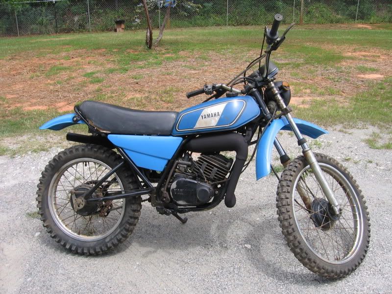

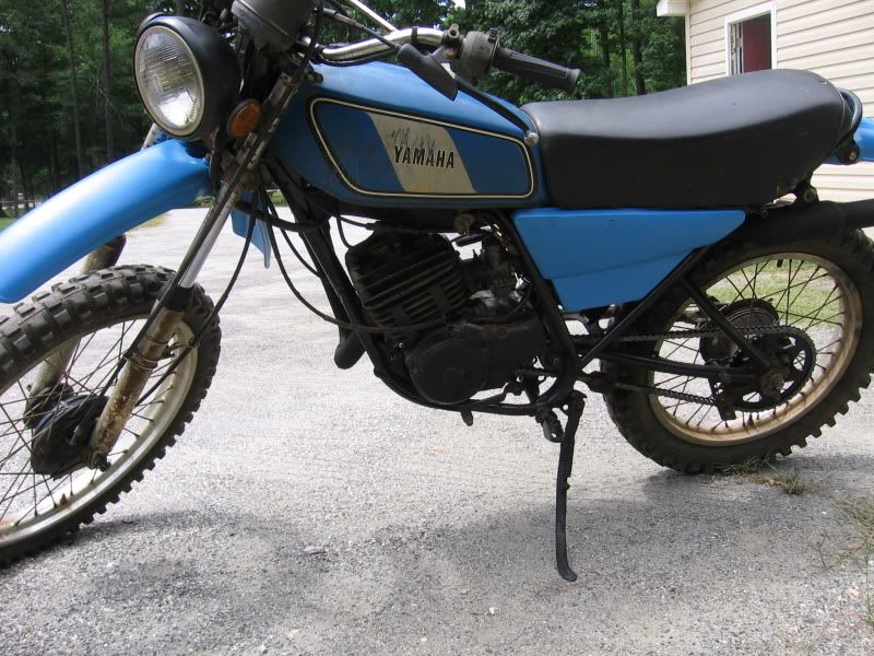

I just finished, for the most part, at getting my first bike. I had a friend who gave me 78 DT175 for free after it had sat under a lean-to for the better part of this decade. He parked it when it lost compression on it one day and he's not much of a mechanic. Turns out he blew a hole in the piston, but the most costly problem was letting the case fill up with water from sitting so long. Well, after a brief binge on ebay, the bike runs again to the surprise of everyone.

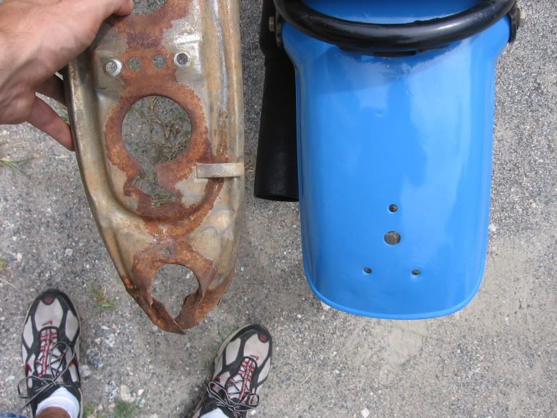

She cleaned up decent. Had to replace the original rear fender with one off a 81' Honda 500. I'll try to get the pictures of the before from my phone.
