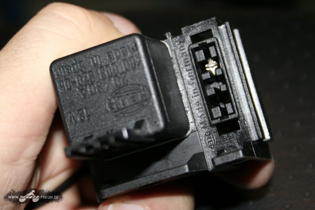

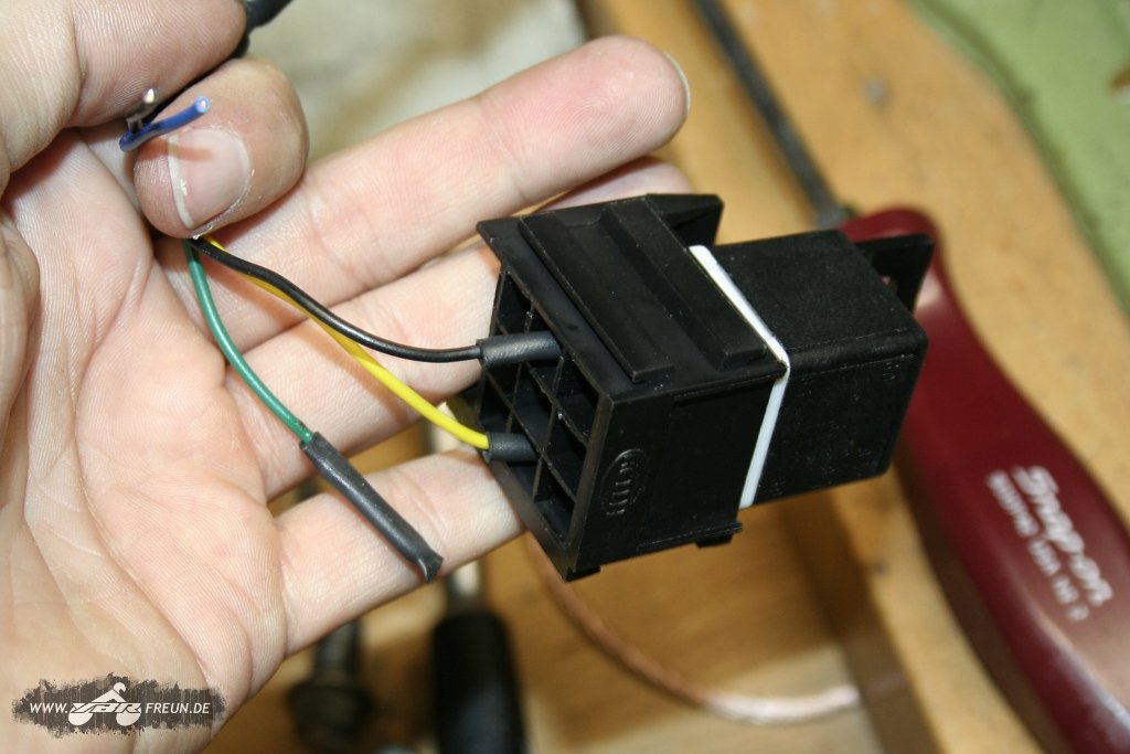

I think the main problem is that they use 35/35 Bilux-AS for a large variety of new 125 cc bikes. I had an old Honda CH 125 Spacy from '93 when I was in switzerland - and the light was even better than that on my VW T4. Thanks to H4. :)
Now I own a '05 YBR 125 and here it is: The same problem like with cars from the 1980s: Bilux-AS, again. :(
I took the old headlight of a Honda CX 400, two solenoids, a fuse and some wire and there it is: Bright as H4 can be.
I think the original wires of the YBR 125 are two short in diameter. So I went for a direct connection to the battery, using the old wires only to switch the solenoids.
I have made a documentation of my conversion: H4 headlight with solenoids. Right now in german language. But using the tiny flag on the top of the site you will get the link to the google translator or maybe some day in the future the proper english translation (if someone got the time to help me translating it).
If someone with a YBR wants to do the same conversion and has some questions -> feel free to ask me via e-mail or here in the thread.
Greetings, Martin
