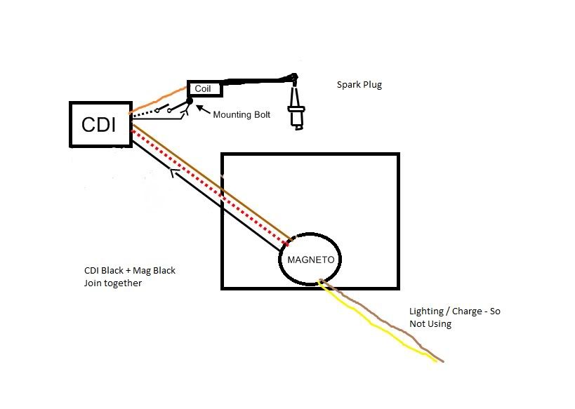

Wired like this?
Every thing minus the Switch is identical to your drawing. Still no spark.
