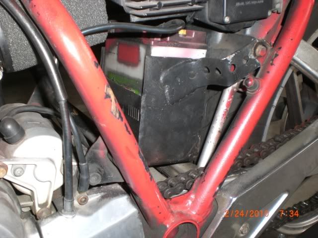

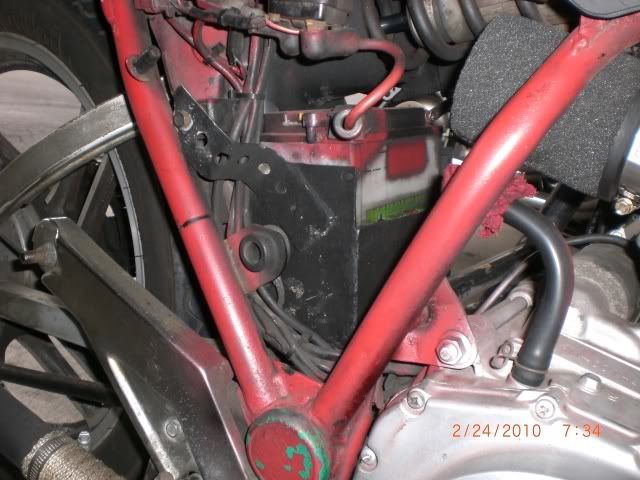

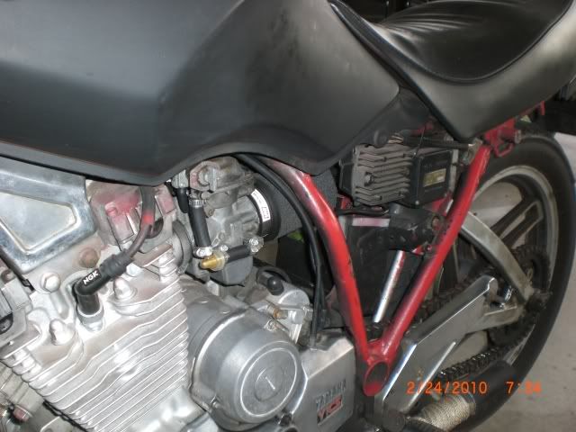

that would be a yes on the sawzall trick that's what i did :lol: i did have to weld up a custom batt box tho . i'll post up some pix
here's the pix of the uni filter's and batt box
pretty much what i was thinking, but the look on my brother-in-law's face when I said I was going to get out the sawzall made me think twice, esp because I'll have to find a place for the battery - I like your box and thats exactly where I was thinking it should go. It'll be a bit before I get it all back together but I'll put up some pics when I do. thanks for the help and the pics!
