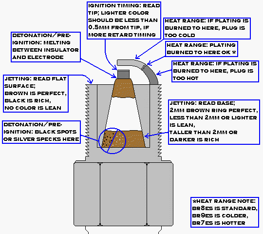

Here's a useful picture
Cool picture, worth keeping a copy  :)
