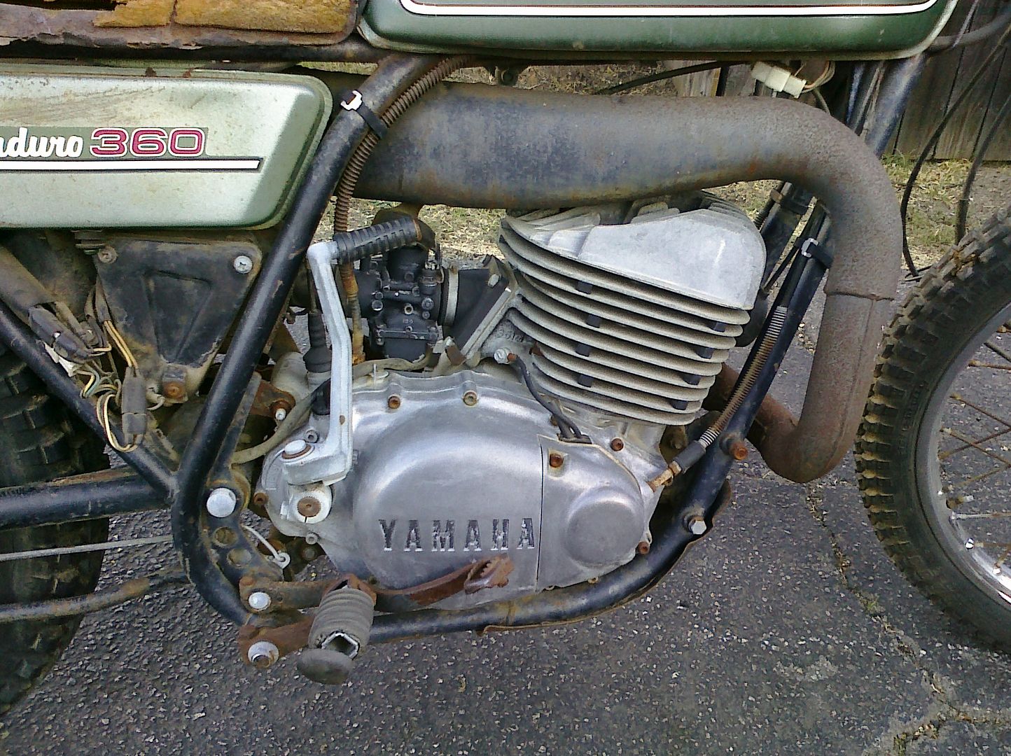

I just picked up a 1974 DT360 today for $150! It's mostly unmolested, but the engine is completely seized. The original spedo is hooked up and it says 5,247 miles are on the bike. The transmission oil looks like new, and it shifts nicely. But in 1st gear when I push the bike forwards or back it will not budge the engine, and the kick starter feels solidly locked up when you try to push down on it. The guy said it ran before it was parked on the side of someone's house in the California high desert a long time ago, but after years and years of sitting in the weather, the engine will not turn over. I sprayed PB Blaster in the spark plug hole in the hopes that it might free the piston rings if the problem is being caused by rusty cylinder walls. If that doesn't work, and I tear the engine down, what are the chances of finding a piston, rings, and bearings for a top/bottom end rebuild?

Yeh keep it stock, its a classic , most parts are available on ebay, whip the head off and take alook at cylinder , dont keep trying to free her off, u"l strip summat else.
They say that diesel oil is a good freeing agent, whip the plug out and pour some into the cylinder and leave it soaking for a few days, that should help to free the piston. You mention the clutch dragging, thats understandable with a bike thats been stood and with a cold engine, nothing to worry about i think there. Good luck with the resto ;)

I started taking some items off the bike in order to try to get a better look in the cylinder before I pulled the head. Other then the surface rust, it's really not in that bad shape overall. I sprayed a little PB Blaster on all the bolts before I loosened them, and they all came out nicely. I pulled off the exhaust and the carb, and I sprayed a little PB Blaster in the engine. It looked like the piston was ok from what I could see, so I figured I would give it one more try today. I stood on the kick starter (I'm 250lbs) and still nothing. But then I said F--- IT!, what do I have to loose?!? I gave it one more good kick and it broke loose and turned over!!! You should have seen me running around like a spaz at that point, I was really happy LOL It sounds/feels like the compression is great!
The carb looks like it's in good shape, but I need to pull the float bowl and check it out inside. The reeds were all slightly stuck closed from sitting for so long, but they look very good! I'm just going to clean them and put em right back in. The wiring seems to be all there as far as the CDI box, ignition coil, ignition switch, etc... I might be able to start this thing a LOT sooner then I was expecting to!
