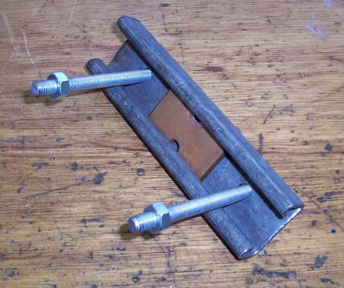

Hi not sure about your bike but this may help anyhow. with my DT175MX (DT175E) in the manual they say use this tool and attach as shown one side in an unused threaded hole and the other side in a threaded hole used for the bearing and seal tetainer ...see pic
I made my own
Goes without saying though that great care must be taken to ensure that nothing mechanical is still holding the cases together or you could quite easily damage the cases.

Thank you Paul, the picture of your puller will help and your statement about being sure that nothing mechanical holding the cases together is still my concern. I guess some careful pulling is the way to go. Thanks again. Meade

Its a tricky position, when i split the cases on my dt175 i used OG's puller and i was the same 'is everything loose' what am i pulling against?
It all came apart OK though, as to the light tap described in the manual, that is suggested to remove the crank from the left hand case, all i can say is that if that is a tap i hope the bloke that wrote it never 'tap's' me on the head.
