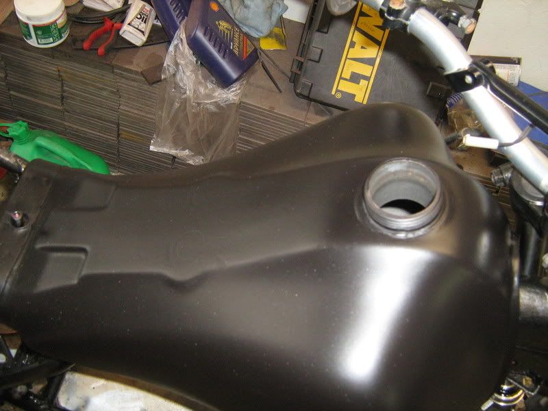

I recently bought a Yamaha DT 175 1992 and have been rebuilding it.
this is how it was when i bought it:
And this is how it looks today :blink:

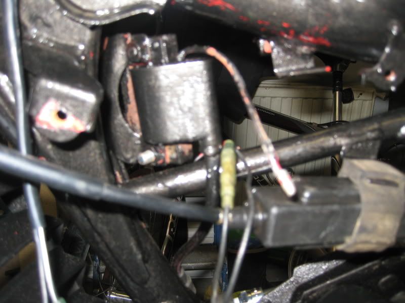

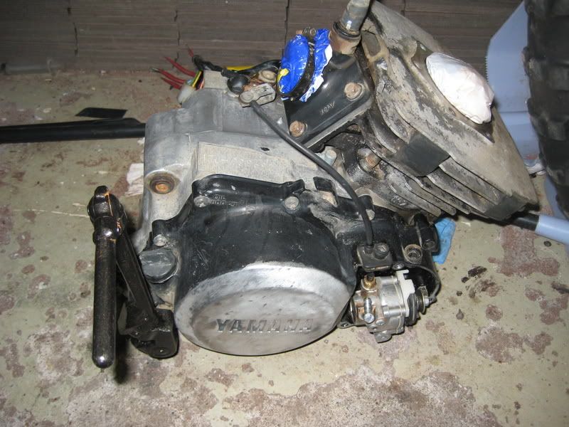

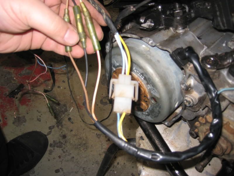

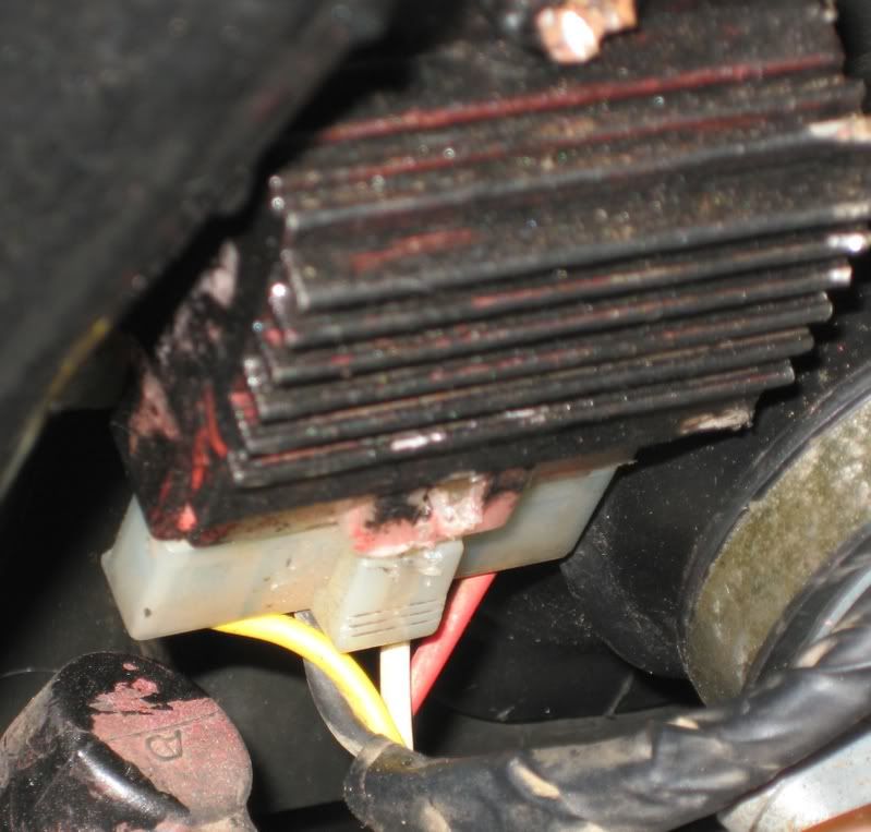

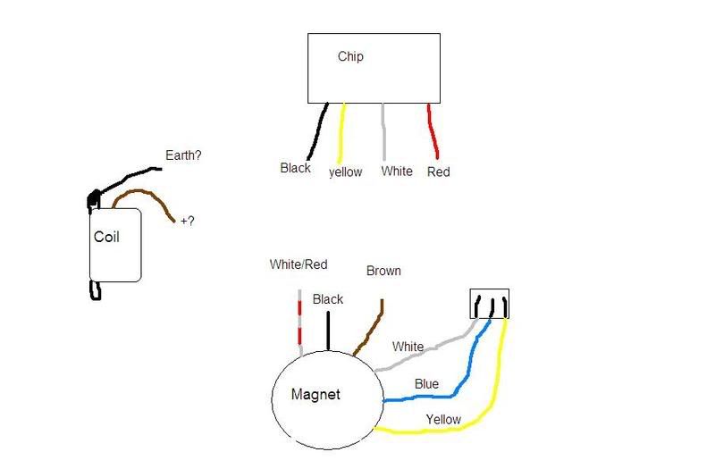

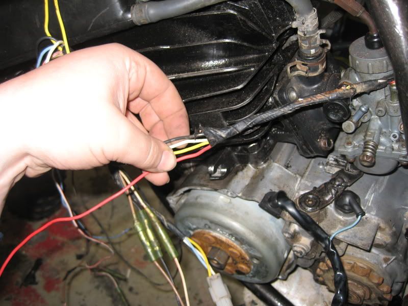

ok now it looks like this:

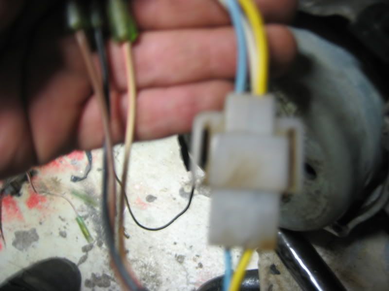

First from the magnet comes white, blue, yellow they are all single but from the magnet also comes White/red, Black, brown
From the ignition box (chip on the picture) comes: Yellow, White, Red, Black

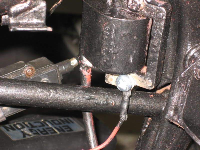

And finally from the coil comes only one wire (orange)
CAN PLEASE!!!! SOMEONE HELP ME WITH THE WIRING??
I will scan mine, hang on, its much older though, i notice youve got the orange coil wire to ground...Why?
Edit... diagram sent.
You will see it is not quite the same as yours, can you not get a manual for this, it is a much later version and was not sold here.
I have seen your bike has been sold in other countries other than iceland, I think it was sols in Australia amongst others, we could do with tracking down a manual because yours is different to the one that was sold here in late 70's early 80's, what you called "ignition box" is our CDI and is rather different, we need to get a diagram specific to yours somehow!
